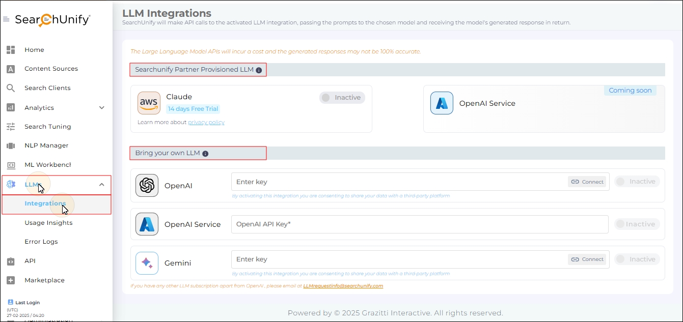

  1. In the Admin Panel, navigate to LLMs and expand Integrations.
  2. The LLM Integrations screen has two sections:
    • SearchUnify Partner Provisioned LLM
    • Bring Your Own LLM
    Fig. A snapshot of the LLM Integrations screen.

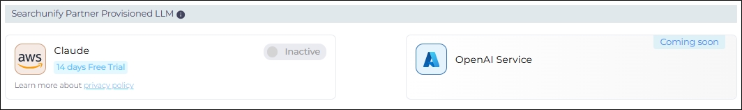

Partner provided LLMs ensure better data security than third-party LLMs and offer a trial period. The current options include:
  • Claude by AWS: It is now available with a 14-day trial. To obtain the authentications details to connect
    SearchUnify with Claude, please get in touch with your IT or DevOps team or the person responsible for administering LLMs within your organization.
    When the free trial expires, contact the SearchUnify team to continue using Claude.
    Fig. The SearchUnify Partner Provisioned LLM section on the LLM Integrations tab.
  • OpenAI Service. This LLM will be removed from the SearchUnify Partner Provisioned LLM section in the upcoming releases.

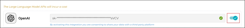

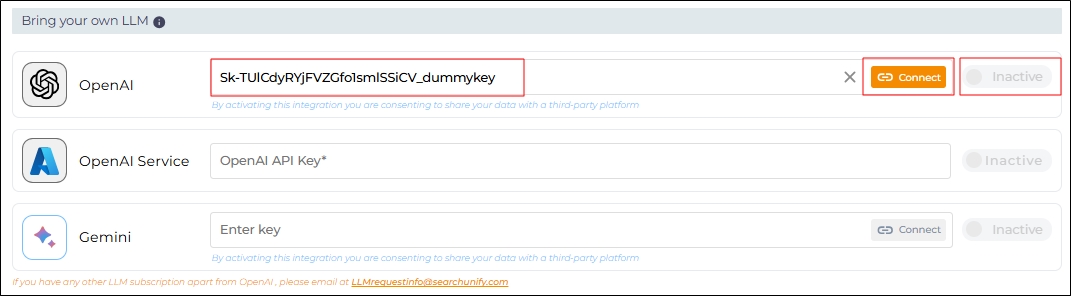

Connecting OpenAI
To activate OpenAI, enter the API key. Then click Connect.
Fig. A snapshot of OpenAI activation.

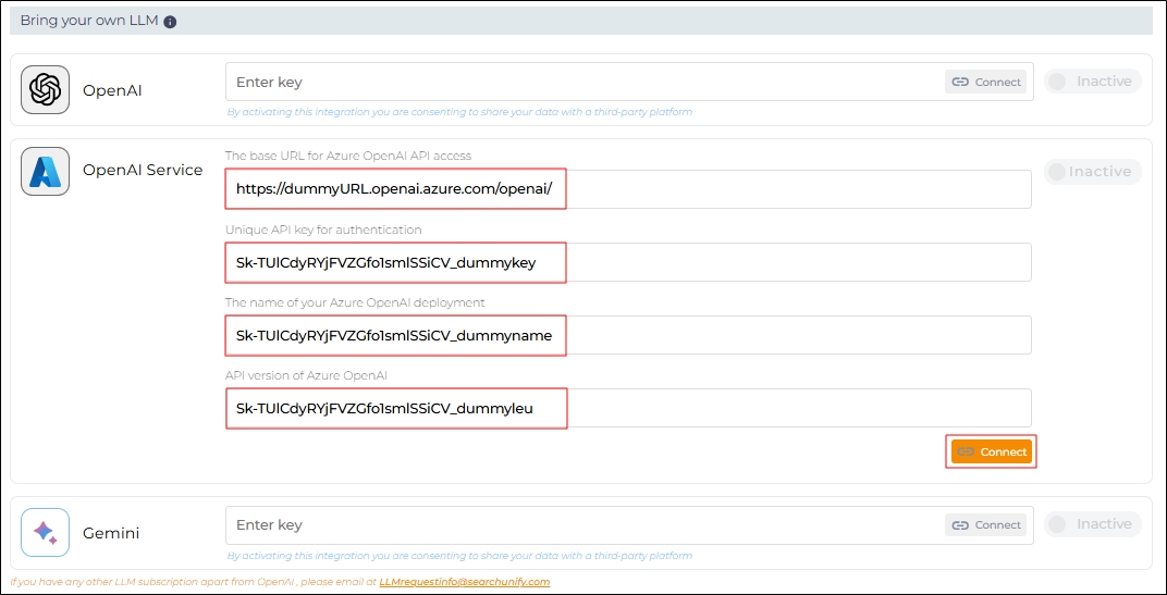

Connecting OpenAI Service
To activate OpenAI, enter:
  • The Base URL for Azure OpenAI API access.
  • The Unique API Key for authentication.
  • The name of your Azure OpenAI deployment.
  • API version of Azure OpenAI.
Then click Connect.
Fig. A snapshot of OpenAI Service activation.

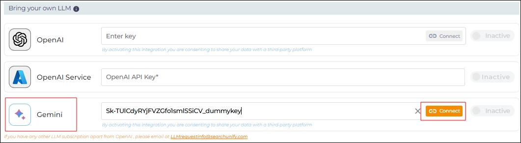

Connecting Gemini
To activate Gemini, enter the API key and click Connect.
Fig. A snapshot of Gemini activation.

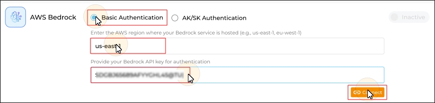

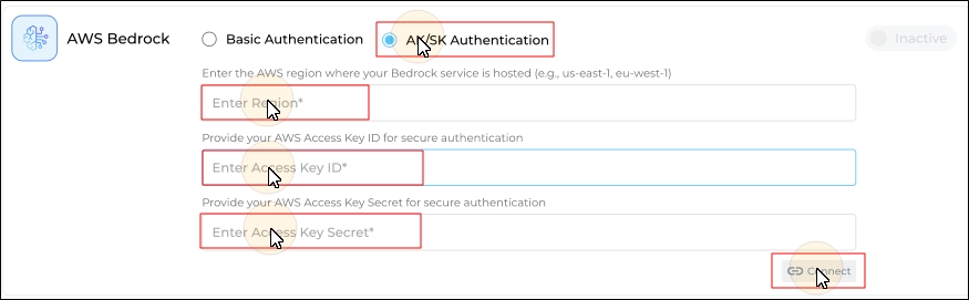

Connecting AWS Bedrock
To activate AWS Bedrock, select an authentication type:
  • Basic Authentication
  • AK/SK Authentication
If you have selected Basic Authentication, enter
  • Region; where region is the place where your Bedrock service is hosted
  • API Key; the AWS Bedrock API key for authentication
  • Access Key Secret; the AWS Bedrock API access key for secure authentication
Then click Connect.
After successfully establishing a connection you can switch the authentication type. However, switching the authentication type will remove all the saved details, disable the AWS Bedrock integration, and disable the SearchUnifyGPT toggle in Search Clients > Configurations, if the toggle is active. After switching, enter the required details again to activate AWS Bedrock.

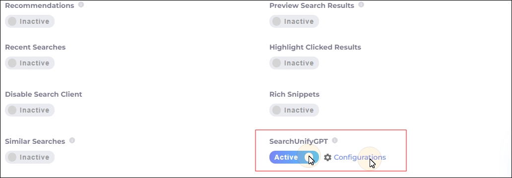

Once you are connected to the LLM, you must activate the SearchUnifyGPT™ to enable the LLM-powered answer box.

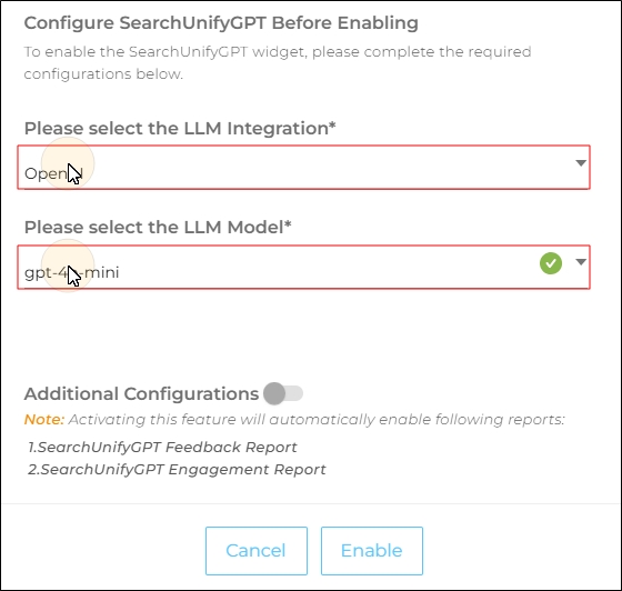

  1. Navigate to Search Clients > Edit > Configurations.
  2. Toggle SearchUnifyGPT™ to ON in the Configurations tab.
  3. Select an LLM platform and a model from the dropdown.
    • Please select the LLM Integration*: Select an LLM platform.
    • Please select the LLM Model*: Select an LLM model.

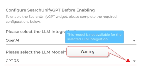

      Note: If selected model isn't in your subscription, you will see a warning.

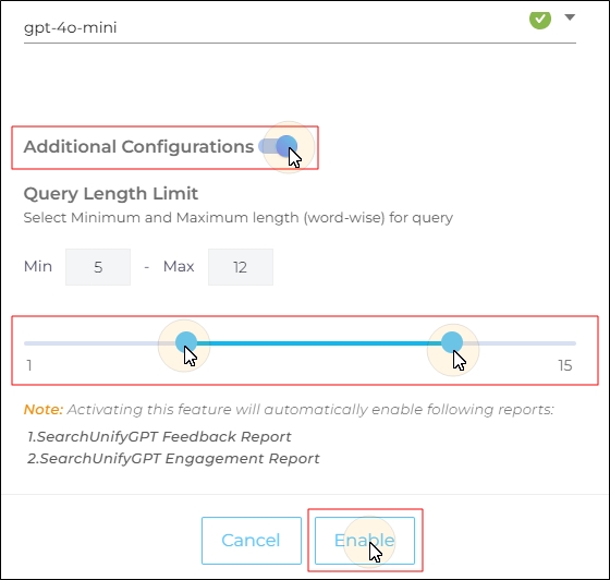

  4. Scroll down to enable Additional Configurations. In this section, you’ll find the Query Length Limit configuration, which allows admins to define when SearchUnifyGPT™ should be triggered.
    For example, if the slider is configured so that the Minimum query length is 5 words and the Maximum query length is 12 words, then SearchUnifyGPT™ will run only for search queries that are at least 5 words long but not longer than 12 words.
    In such a scenario:
    • A query like [set up Salesforce content source] (5 words) will trigger a response in the SearchUnifyGPT™ widget.
    • A query like [set up Salesforce] (3 words) will not trigger SearchUnifyGPT™.
    Note: Stopwords are not ignored. For example, the query [salesforce is a content source] is counted as a 5-word query.
    The default values are:
    • Minimum query length: 1 word
    • Maximum query length: 6 words
    After defining the Minimum query length and Maximum query length, click Enable to activate the configuration.

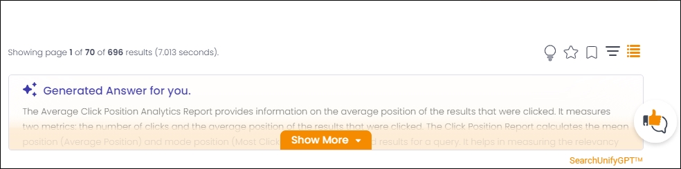

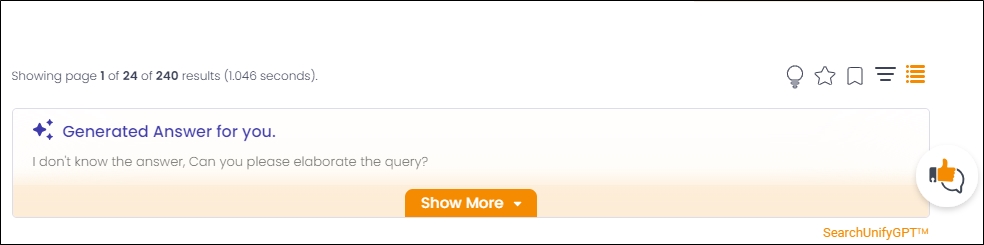

Once you have connected to an LLM and activated SearchUnifyGPT™, the LLM-powered answer box will appear before the search results. The text in the box changes when you apply facets. But the text doesn't change after page two and beyond. You won't see SearchUnifyGPT™ upon running an empty search.
Fig. A snapshot of an answer generated in SearchUnifyGPT™ .
Users can view the complete answers by clicking Show More.

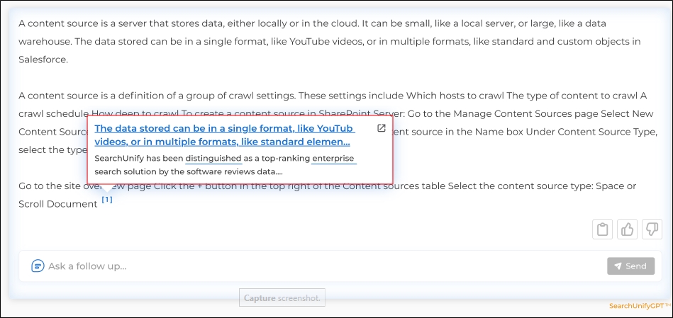

The sources used to generate the answer are listed in the widget. The users can hover the cursor over a source number to view details.
Fig. A snapshot of the link details dialog, when the cursor is over a reference.

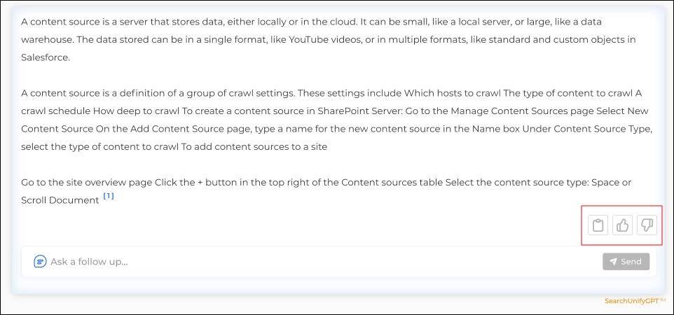

The users can share feedback on the accuracy of the data in the widget using the thumbs-up-and-thumbs-down feature. The feedback is captured in the SearchUnifyGPT™ Feedback Report.
Long answers in the widget can be copied using the Copy button.
Fig. A snapshot of the copy text, thumbs up answer, and thumbs down answer buttons on SearchUnifyGPT™.
