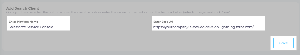

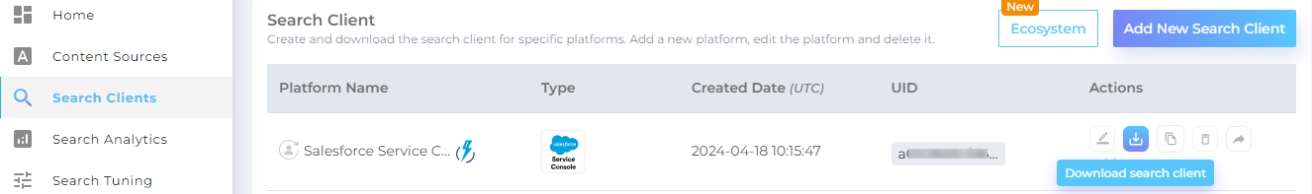

Create a Salesforce Service Console search client. Log into your instance, go to Search Clients, pick "Salesforce Service Console", enter a label in Enter Platform Name and your instance URL in Enter Base URL.Then, click Save.
Configure the Salesforce Service Console search client. Refer to Basic Search Client Configurations
Download Salesforce Service Console Search Client
Download the Salesforce Service Console search client that you created.

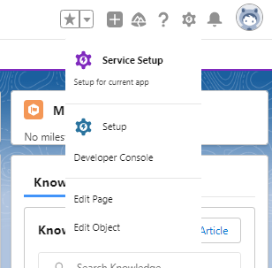

in Salesforce, select Setup. Use Quick Find Box to find Users. Click Edit and check the Knowledge User box.

in Salesforce, go to Service Setup. Find Knowledge Settings from Quick Find Box. Then check Yes, I understand the impact of enabling Salesforce Knowledge. and click Enable Lightning Knowledge.

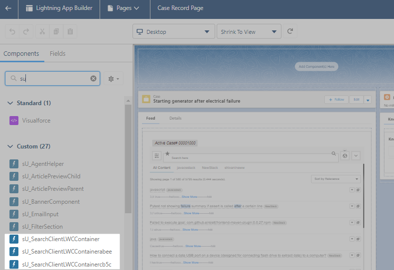

Open a case in Service Console.
Click Edit Page.
Find sUSearchClientLWCContainer{ABCD}. The {ABCD} in the component name contains the first four letters of the search client UID. These letters distinguish components from one another when you have several of them installed in the org.
Refer to the below video on how to drop the component on the case details page.

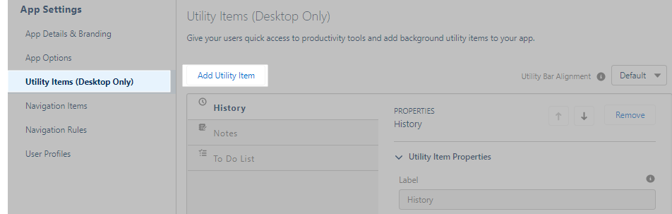

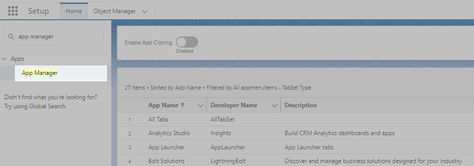

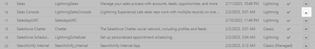

Go to App Manager.
Open the app where the search client is installed for editing.

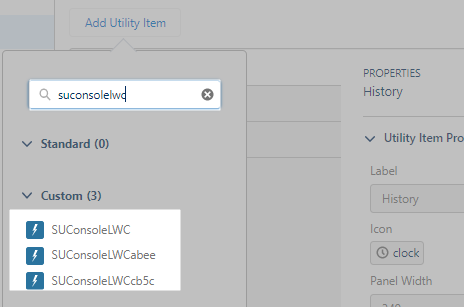

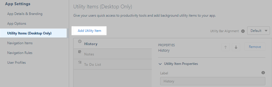

Go to Utility Items and click Add Utility Item.

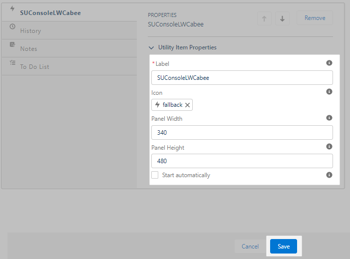

Add the component SUConsoleLwc{{ABCD}}. The last four letters of the component contain the first four letters of the search client UID.
Configure the size of the component and click Save.

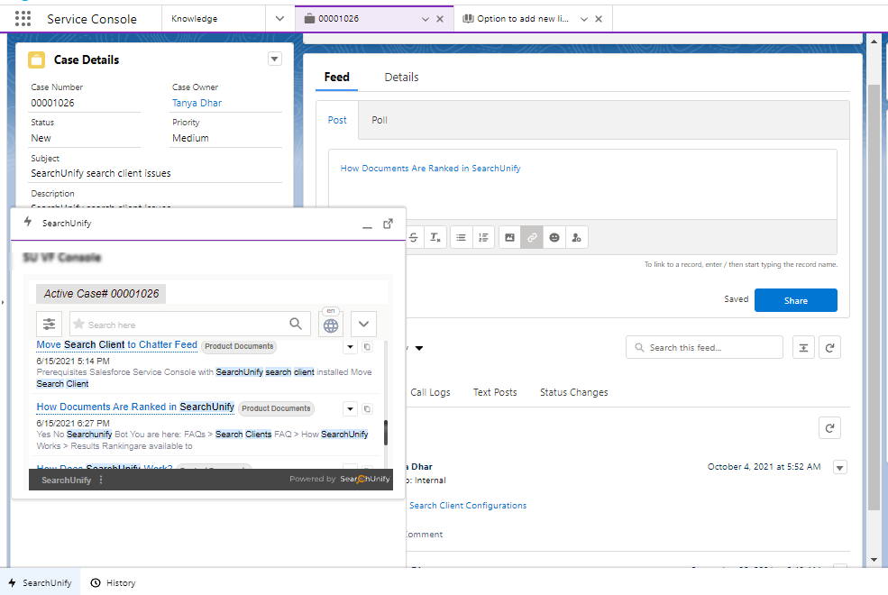

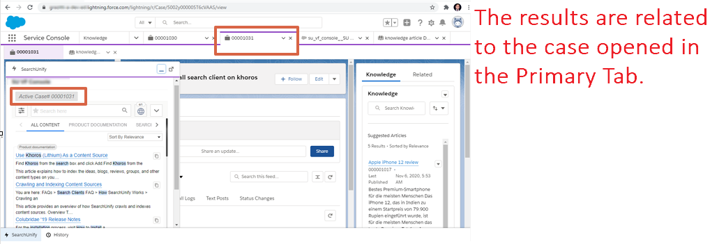

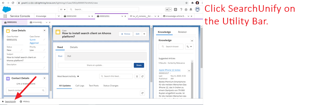

Upon installation, SearchUnify is added to the utility bar. Click it to launch the search client.
When the search client is launched, it presents results related to the case opened or active in the Primary Tab. When you switch between two Primary Tabs, the results page refreshes — so that the results are related to the active case. Navigation between subtabs doesn't refresh results. It means that you can use the search function in subtabs.

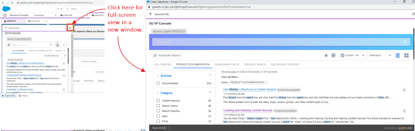

Agents who run complex searches on a regular basis or need more information to scan simultaneously can switch to full-screen view by clicking
. After maximizing the search window, you have to run your search again. That's because Salesforce automatically refreshes the search page and your query disappears.

copies a hyperlinked result title in Salesforce Lightning. In Salesforce Lightning, the link contains the URL of the copied result, which can be pasted on a case page. In the next image, the second result "How Documents Are Ranked in SearchUnify" is copied from the search client and pasted on a case page.
